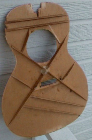

I have a little Gibson book and will go consult it.
From page 30:
Body length 19 3/8 "
Lower sides depth 4 5/16th "
Upper sides depth 3 1/4 "
Soundhole dia. 4 "
Upper Bout 10 1/4 "
Lower Bout 14 3/4 "
Waist 8 1/4 "
Photo of bracing 1935 L-00, linked off Burkett Guitars Website
Dimensions of a Collings C10
* Nut Width: 1 11/16"
* Scale Length: 25 1/2"
* Body Width: 14 3/4"
* Body Length: 19 1/4"
* Body Depth: 4 1/4"
* Total Length: 39 1/2"
